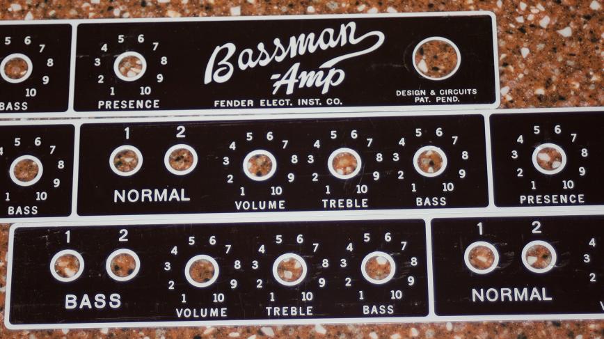

I could be wrong but I think Matt was talking about where the knob was pointing, rather than the number on the amp. I'd say 9 o'clock usually is a volume set at about 3, and noon would be maybe 5/6, like on these Bassman faceplates:

Thanks, Mel. That was exactly what I meant. Like a clock face. The amp I was playing through would be the equivalent of a 15-watt Class-A Vox type amp. I also didn't attenuate the volume or tone controls on the guitar, they were wide open on all the samples. On the 'Low Gain' samples, 9 o' clock would have put as at just under "3" on the faceplates in Mel's picture. On the 'Med Gain' sample, at 12 o' clock, that would be between "5" and "6", pointing straight up. The volume control on the amp was also at about 10 o' clock for both the 'Low Gain' and 'Med Gain' samples.
