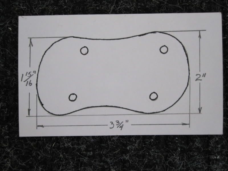

Don't know if you need this or not, but here it is in case someone else needs it. It's made of approximately 3/32" plate steel.
Re: Bass Time!
Postby Sarah93003 » Mon Jul 12, 2010 10:33 am
Hey Danny,
is that the plate for a bass? I have a back plate that I bought from Andy and it is 3 3/4" long by 2" on one end by 1 13/16" on the other end by 0.090" (3/32") thickness. The holes on mine are 9/32" diameter with a bit of a champfer for the screw head. I wonder if there was a difference in these plates between the guitar and bass or between the years that they were used.
Re: Bass Time!
Postby oipunkguy » Mon Jul 12, 2010 11:31 am
sarah I think the plates are the same for both. it would make since to have one plate for both, it would save money in production cost. fender neck plates are also the same size for bass and guitar.
