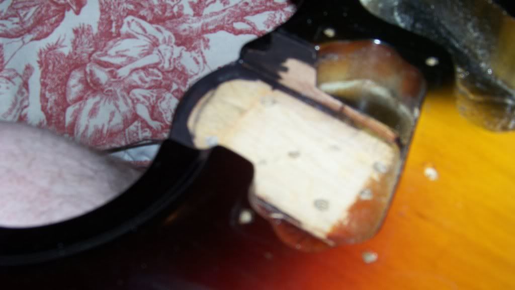

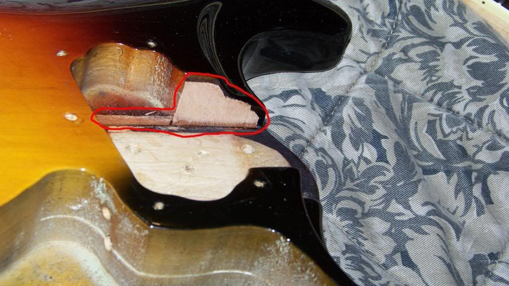

what I noticed is that the neck fitted fairly loose inside the neck cavity. therefore, it's possible that the sound is getting killed here. so I superglued in some mahogany wood veneer inside the cavity to get a tighter fit. once the glue dried, and did some light sanding...

I attached the neck again, and it fitted a heck of a lot tighter, so I colored in the veneer with a black sharpie, and put my baby back together.

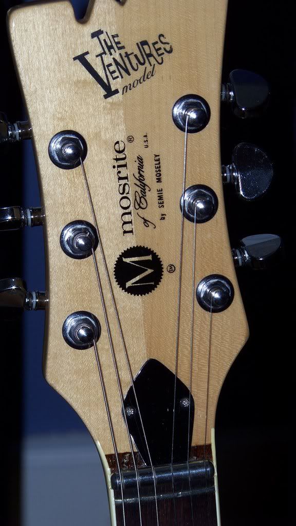

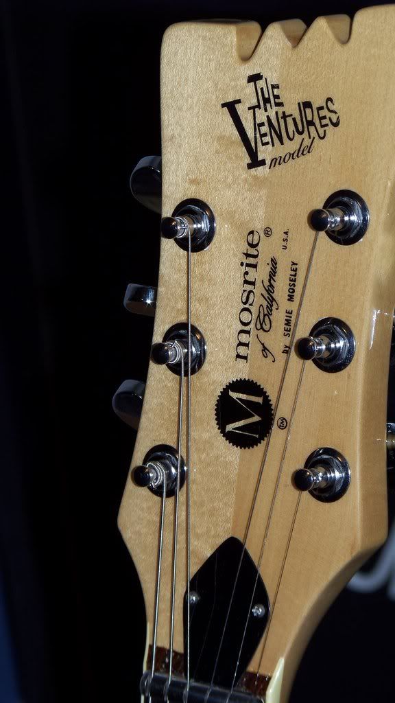

there's nothing sweeter then a mosrite with a fresh setup and a fresh pair of strings. But I added one more thing. a ventures decal :D
for those that get mad at me, cuz it's not a real ventures, relax, I know. and the decal is above the finish, so I can scrape it off with a fingernail if I want, so it's obvious that it isn't original to the guitar. but it sure does looks cool!

I tried the guitar out tonight, and I did notice an improvement in sustain. however it's still not as close as my les paul. the mosrite does sustain more in the middle and neck pickup positions then the bridge position, but I still plan to have Ed rewrap the pickups for me, and maybe that'll help out a lot.
