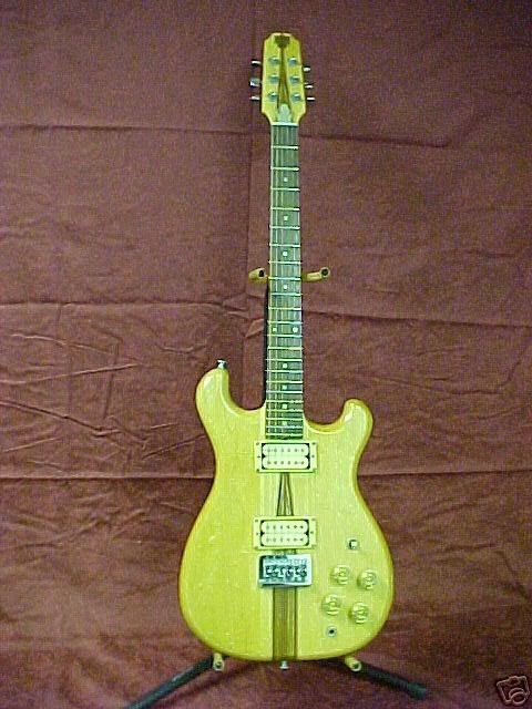

Sarah93003 wrote:dorkrockrecords wrote:Sarah -
I believe that is the short-lived Dobro brand foray into solidbody electric guitars, made back in the late '70s or early '80s.
Adam
That would be very interesting Adam. Can you point me in the right direction to look into that?
http://cgi.ebay.com/ws/eBayISAPI.dll?Vi ... 0491351113
