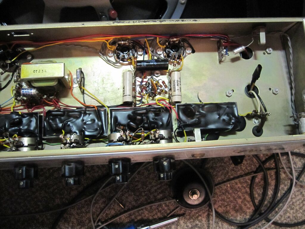

I just got this Standel amp - a local craigslist deal. The model number is 82L15V, and the faceplate says "Custom transistorized". Two channels, normal and vibrato, each with volume, contour, treble and bass, and speed and intensity on the vibrato channel. It's a hybrid amp, with a solid state pre amp and a tube phase inverter and power amp. It's got the dreaded potted modules, and sadly the vibrato doesn't work. The guy I got it from bought it from his guitar teacher in the 60s.

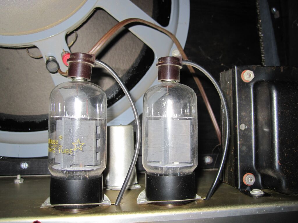

So, Standel mavens - what do you know about this amp? I couldn't find any schematics for it, or whether replacement / work-around vibrato modules are available. What are those power tubes? I couldn't see any tube model on them.

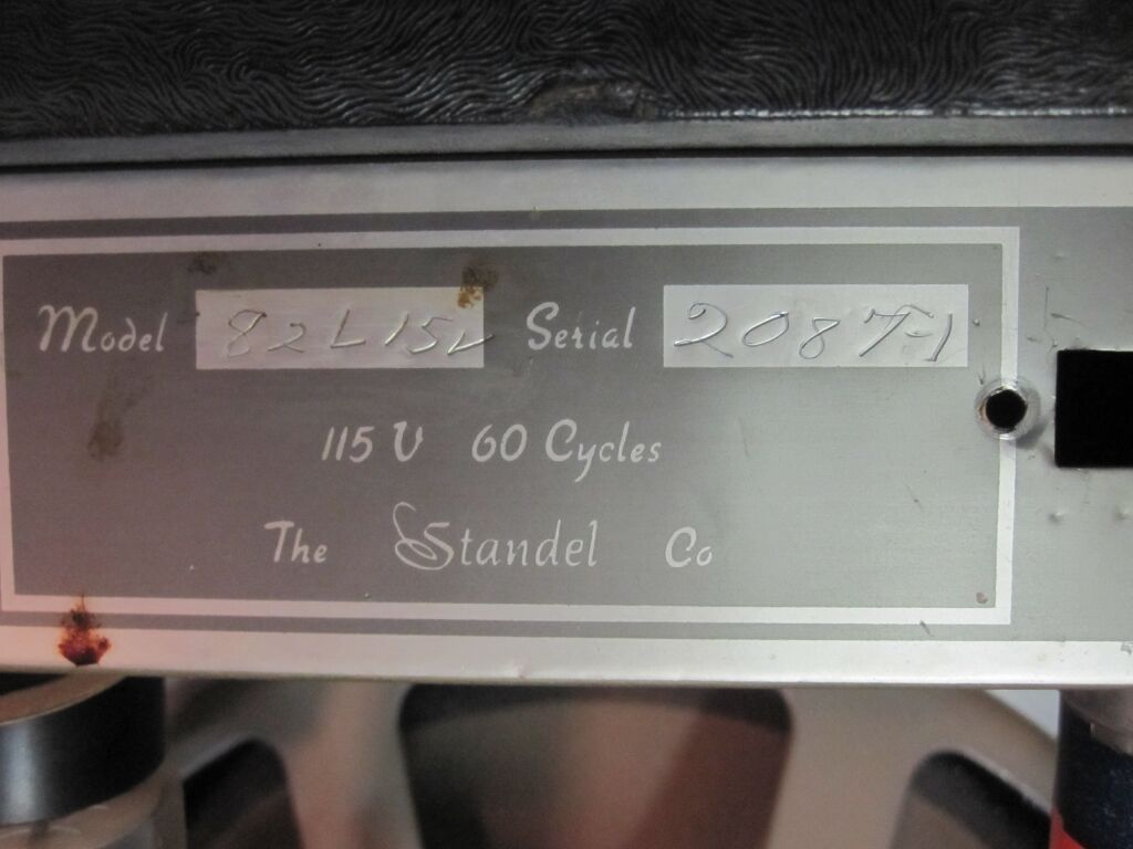

Model and Serial number

What are these tubes?

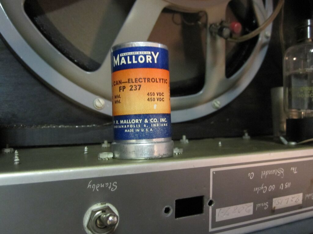

Cap can
Guts. Notice the modules. The one on the left is stamped Sept 1962

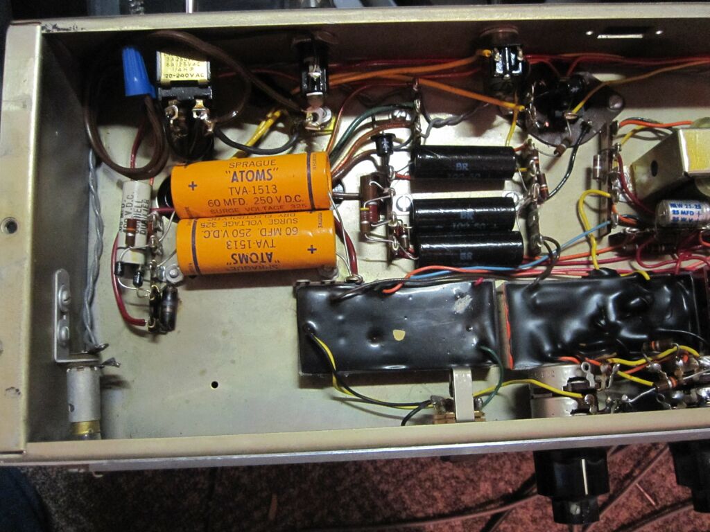

More guts. The vibrato module is the second from the left (I think).

The Hybrids are great amps. I contacted the seller about this one, but apparently you beat me to it! The tubes are probably 6GT5s. They are easy to find in the vintage TV circles, a little scarce for vintage guitar amps. The good news is that since they weren't really used very often in audio only circuits, the design tolerances of your amp will allow you to put just about and pair in there. Matching is not an issue in other words...
The epoxied modules are the biggest problem with these amps. If one goes south, then you have to replace it. Just go to Guitar Center and get a new one, right? Actually the guys at the New Standel may have schematics for this model, but you'll probably have to improvise.

The tubes are 6DQ6 or 6DQ6A tubes. Bob Crooks (the guy who made these amps) told me that he bought 100,000 of these tubes at an auction for 100 bucks and designed an amplifier circuit around them. The tubes are still easily found at Antique Electronic Supply for about 4 bucks each.

Did I give you Danny McKinney's contact info at the new Standel company? I believe he can still be reached at danmckinney@earthlink.net He definitely has some of the potted module schematics, so he can probably hook you up with a schematic for the vibrato module.

So, any idea what the phase inverter tube is?
